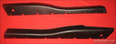

I had a couple hours this morning to work in the garage, so I decided to finish up transforming the passenger-side kick panel area from an AC-type to a non-AC (manual vent) style.
First I had to fabricate a sheetmetal plate to cover the hole in the kickpanel area. I riveted it over the hole and then marked out where I needed to cut to allow the vent-style kick panel to protrude through. I used an angle grinder and cut-off wheel to rough in the hole, and then cleaned it up with a die-grinder. Unfortunately, I ended up roughing the hole in a bit too large, and by the time I got it cleaned up, the hole was a little too tall. It would have worked OK and been completely invisible, but it still bugged me, so I ended up drilling out the rivets to remove the cover and fabricating a new one with a slightly smaller hole, which will allow the kickpanel to mate up better for better sealing. In the end it actually turned out pretty well.
The second picture shows the first attempt at cutting the hole, and you can see how the top of the hole is a bit out of shape. I didn't take pics of the re-do, but it's essentially the same, only a bit smaller. Now I just need to paint my handiwork to make it disappear, seal the kickpanel cover to the body with some 3M rope caulk, and then I can get started on the firewall cover...but due to a busy weekend with my daughter's two dance recitals, that'll have to wait until next weekend.
