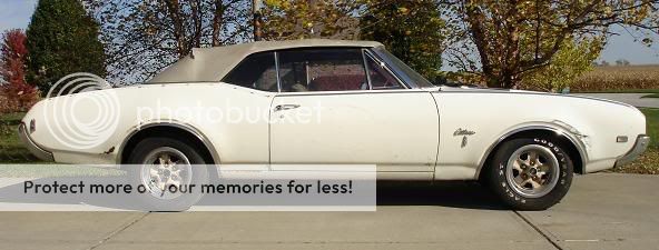

Okay, here we go...!
The car.
1968 Oldsmobile Cutlass S Convertible - 350 4bbl JetAway & some options like remote mirror, trunk release, console/buckets, etc..
99K original miles. All original : numbers matching engine/trans..
Its a Lansing car that (IIRC) was orginally sold in WA and migrated to the midwest via Iowa then northern Indiana around 1980 (found some old paperwork).
I bought this car back in the mid 80's from a distant friend-of-a-friend. I had been looking for a '67 Cutlass 'vert but saw this and went for it. It was my daily driver thru hell & high water for several years. Around 1990 it was hit in the left rear while parked (on the Circle downtown if you know Indy ) by a delivery truck. I watched it happen from ~ 100ft away ...I tried to find parts, but had little if any luck & didn't have the time or place to deal with it. So, I stashed it in a friend's barn....then a storage lot...then my garage..then another garage..etc..for ~18 years. During that time I found some parts to fix it.
Its a 'northern' car...coated with that tarry goop everywhere, but I think it worked ! Frame, front fenders & hood are nice. Floor is good except a couple spots in the rear wheel well floor area (very rare here in the rustbelt not to be rotted bad). Doors are OK, but I have a better pair. Quarters are shot, but I have a pair of OEMs that should work. The only 'ifs' are the decklid & rad support. The guy who's going to work his magic with body swears that everything is much better than "good enough to use"..... Looks rough to me, but I'm just a passable shadetree wrench and in no way a sheetmetal guy...
Pics above are from 7 days ago.
5 days ago I started disassembly in prep for it moving to a shop where he's going to brace & pull the shell.....
Then all sheetmetal goes off to media blast....
Our story thus far.....
(Please remember : I am not a professional ! Just a guy with some tools !)
Fire away with questions....I'm sure Ill be asking some too....
Sorry about the long post ! I'll try to keep 'em short in from here on...!

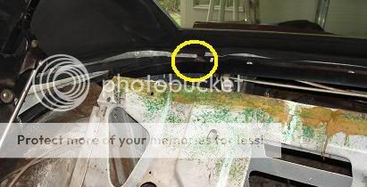

Now have all stainless off ...
All glass out, doors gutted (exc lock) & everything out of the interior 'cept the dash area...
Its not near as rusty as it looks in the pics. A lot of the rust color is 1. Dirt, 2. Leftover underpadding still stuck to floor, 3. Some old spray on adhesive (back seat area mostly). Around the back seat area there's also a ton of sprayed/glopped on hardened tar-like stuff that has the rust-colored adhesive over it.
Also got a bonus ! When I got to the rear drip rail,
I found....
No wonder that guy charged me an extra $5 when I had the top replaced.....!
Notes:
Man, it takes as long to bag & tag everything as it does to remove it...
Window & regulator removal SUCKS. It took me 2+ hours on the first door to get 1/4 & main glass out - 30 mins the next. Rears were 1+ for first, 20 mins for 2nd.
You may notice the top is down. Ran jumper cable from batt on floor. Clamped neg to body, clamped a long thin bolt in pos. I unplugged the pump motor and would touch the bolt to the blade in the connector to run it up an down. You may also noticed there's a roll up garage door on the driver side and the tracks are over the car. I asked my 6yo son to watch and tell me if the top was going to hit it (I couldn't see 'cuz I was under the top). I moved it a bit, a bit more, a bit more & bang. He says 'Yep, you hit it.'....Uh, thanks son!
I figured out that I could pull it under the rail by hand once it was close.
Some questions..
1. Is the back glass worth anything ? I sliced it out with ~ 3 inches of top all around. Looks to be plastic welded in. IIRC, new tops come with glass....
2. Do I need to save my 3 pieces of tack strips ? Or do they go in the trash w/ the rear glass ?
TIA
More to come....

Moving day !
Alrighty...Its time to head off to the body shop....
I pulled out the spare set of doors and stripped them. I had forgotten just how good they were. The drivers side has absolutely no rust & the pass side had only a small (<1/2" dia) perf at the lower leading edge. Just tons of wasp/spider nests. Only flaws are the rivet holes from that cheesy trim strip. Oddly, there were 2 different pieces of main glass. Driver's was green & pass was clear. Made sense because the remnants of the original green pass side were in the bottom of the door.
Here's everything ready to roll...just waiting on the rollback for the car...(core support & rad top panel are in my truck - hood's on the floor of the car.)
and a closeup of the donor shell.....
I got the shell ~12+ years ago from Oklahoma. I got all sheetmetal from the cowl on back. The cowl was trashed (story was that it hit a train - the front end was smashed 45 degrees up & 45 degrees over- we found traces of the occupants on the windshield frame...ewwww) , but the doors & 1/4s were good so I pulled the doors & cut off the rest.
The journey continues....
Indy_68_S is offline   Reply With Quote

Things are taking longer than expected ......(hehe...). Its now in the shop...
Anyone know where I can find a good top cowl/base-of-windshield piece ?
Once my guy popped the glass out & cleaned the channel we found that the rot was worse than expected. Its pretty perforated along the width.
I've found the various Chevelle & GTO patch panels, but it looks like I'll need ~ 1-2" into the dash metal and I'm not sure how much the panels cover. I've seen people (here & elsewhere) replace/repair this with donor metal.
Anyone have any ideas ??? (& maybe a good deck lid ??)
TIA
I'll post up pics as soon as I can...

Good old parts place! BP-5542T is for a 68-72 El Camino.Why they continue to list as Cutlass is beyond me.Steer clear!

Post a photo of the problem area if you can. It might be worth saving by having your body guy weld new metal strips in there.

I rebuilt my area under the windsheild. I had a hole on the passenger side and repaired it myself. Some metal strips welded in or fiberglass if the repair is small enough. A donor car is probably better because the curves are complicated but a good body man can possibly repair it. Your car looks pretty solid overall, 68 is my favorite year!
